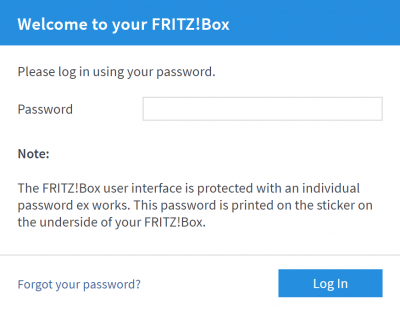

Log in op je FRITZ!Box via http://fritz.box/ of http://192.168.178.1/.
